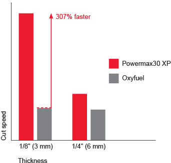

Relative cut performance on mild steel (chart)

  • High-power cutting on thick metal
  • FineCut consumables enable high quality cuts on thin metal, leaving a clean edge and a narrow kerf
