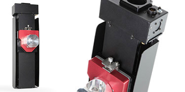

  • Optional Sensor™ plasma torch height control mechanics (Sensor THC)

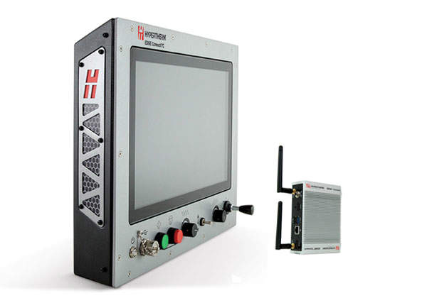

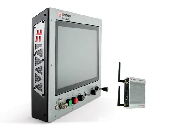

The smallest of the CNC configurations, the EDGE Connect offers the greatest flexibility for machine integration. Cutting machine OEMs provide the touch screen and any operator switches.
EDGE Connect TC
EDGE Connect TC
Integrates the EDGE Connect CNC into an industrial enclosure with a 495 mm (19.5") touchscreen. A hardware operator’s console with switches for start, stop, program and manual speed control, raise/lower torch and joystick is included for easy operation.
