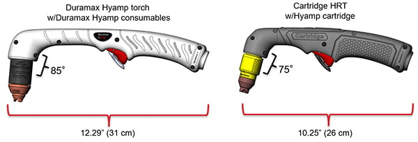

  • Comfortable, ergonomically friendly 75° hand torch.  For Powermax125®, much smaller and lighter than Duramax Hyamp torch.
