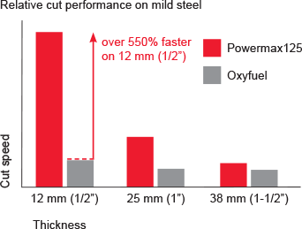

Maximum productivity
  • Finish jobs faster with cut speeds five times greater than oxyfuel on 12 mm (1/2”) mild steel

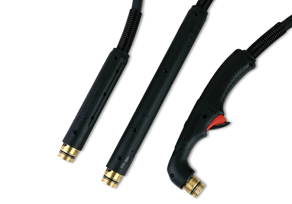

Torch and cable options
Duramax Hyamp torch options
  Hand torches Machine torches
Cable length 85° 15° 180° Mini 180°
4,5 m (15′)     059519 059514
7,6 m (25′) 059492 059495 059520 059515
10,7 m (35′)     059521 059516
15,2 m (50′) 059493 059496 059522 059517
22,8 m (75′) 059494 059497 059523
45,7 m (150′)* 059665 059664   059666
  Robotic torches
Cable length 45° 90° 180°
7,6 m (25′) 059564 059565 059566
15,2 m (50′) 059670 059671 059672
Long torches
Cable length 0,6 m (2′), 45° 0,6 m (2′), 90° 1,2 m (4′), 45° 1,2 m (4′), 90° 1,8 m (6′), 45° 1,8 m (6′), 90°
7,6 m (25′) 059562 059563 059567 059568 059758 059623
15,2 m (50′) 059579 059580 059581 059582 059759 059624
45,7 m (150′)*     059667 059668
*45.7 m (150′) torches leads are compatible only with Powermax125 systems with a serial number 125-007944 or higher.

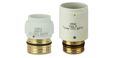

Powermax cartridge upgrade
Hyamp cartridge adapter
The Hyamp cartridge adapter provides a simple upgrade to convert from the use of standard Duramax Hyamp consumables to the new Powermax cartridge consumable platform. The Hyamp cartridge adapter allows conversion to the cartridge platform if you have the following systems and torch types.
Hypertherm cartridge adapter
System
Torch type
Adapter part number
Powermax125®
Duramax Hyamp hand, machine, robotic, and long
528160

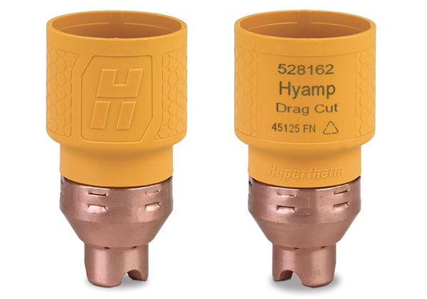

Hyamp drag cutting cartridges
Hypertherm cartridges
Process
Cartridge
Hyamp
528162
105 A
428937
85 A
428935
65 A
428931
45 A

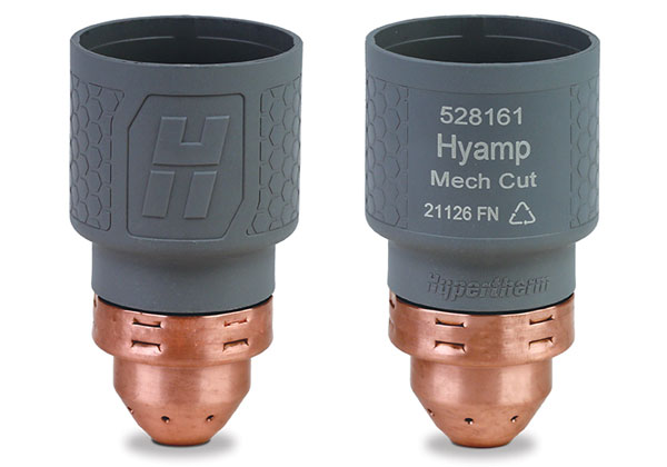

Hyamp mechanized cartridge
Process
Cartridge
Hyamp
