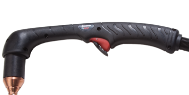

Designed for durability and reliability, Duramax® Hyamp™ torches are built to handle the full 125-amp output of the Powermax125® plasma cutting system and are also compatible for use on lower amp Powermax® systems. Duramax Hyamp torches are available for handheld and machine cutting and gouging, and robotic cutting. In addition, Duramax Hyamp Long torches are available in .6 m (2′), 1.2 m (4′), and 1.83 m (6′) lengths providing extra reach and durability for heavy-duty applications like scrapping, plate skeleton removal from cutting tables and infrastructure repair or reconstruction.
Duramax Hyamp torches are available with an extensive array of specialty consumable options that perform a variety of applications such as gouging, fine feature cutting, extended reach cutting, precision gouging, cutting flush to base materials (flush cutting), and marking.

For hand cutting and gouging jobs
Duramax® Hyamp™ 85° and 15° hand torches are well suited for most hand cutting and gouging jobs. The ergonomic design of the 85° torch is perfect for normal cutting, while the 15° torch directs heat away from the operator during heavy gouging and enables cutting overhead or in hard-to-reach areas.
